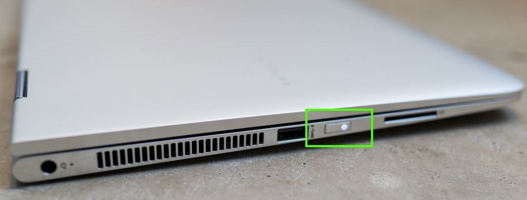

2. While powered on, hold down the power button for around 15 seconds. The laptop should power off but hold the button for the allotted time.
3. Connect the charger to the laptop and power on. The laptop should boot into the operating system as normal.

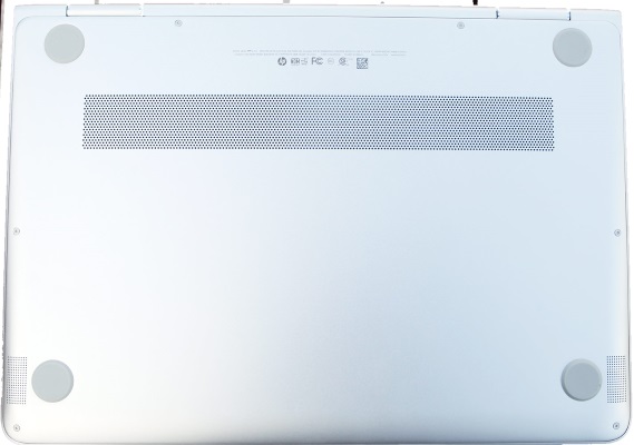

2. Place the HP Spectre X360 face down on a clean work surface.
3. Remove the eight Phillips screws holding the bottom enclosure in place. The screws are two sizes, keep them safe and where they won’t get mixed up.
undefined
4. Disconnect the battery cable. Removing the battery is optional but not necessary for a hard reset.
5. Reconnect the battery cable and replace the enclosure.
