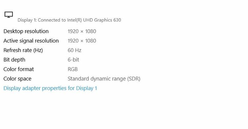

This problem just started recently and I don't know if it's because of an update or something else that happened. When attempting to launch the game, I would get a Direct3D Initialization Error. I did find multiple threads on steam relating to that error and it suggested I try deleting the options.txt file for the game itself so it could be recreated. If not that, then try changing the resolution in the file's options or change it to windowed mode. Of course, none of these suggestions fix the issue. I finally discovered what the problem was. It turns out that the Intel(R) UHD Graphics 630 was being used rather than the NVIDIA GeForce GTX 1050 ti driver. This is shown in DirectX Diagnostic Tool along with the advanced display settings.
I then disabled the UHD Graphics 630 in the device manager. At that point, I think all is well.
