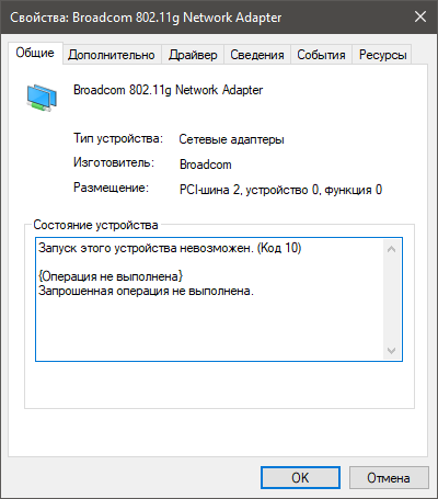

Hello! In general, my laptop has been working for many years and there are no problems with it. About 6 months ago, there was a problem that the WiFi was turned off, rarely. Now it has become very common. Moreover, this is important (!), wi-fi is turned off only after the laptop comes out of sleep mode (standby mode). At the same time, the touch button on/off wifi does not work; checking the equipment does not help. At the same time, the wifi adapter is marked as not installed in the Device Manager.

And after such a screen, rebooting does not help. I try to restore the wifi in different ways, for example, through Resetting the network. Sometimes it helps. But sometimes the wi-fi adapter doesn't show up in the Device Manager at all.
In addition, I also tried to install other drivers manually downloaded from the Internet, in the hope that this would help, but it did not help. I removed Kaspersky anti-virus for a few days, but it didn't help either.
It turns out that it seems that the wifi adapter itself works and Windows sees it and the driver, too, but, as I said above, after the laptop comes out of Sleep mode (Standby mode), the wifi adapter is not detected by the system.
