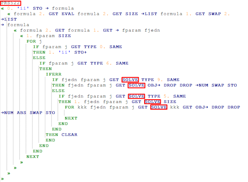

I have one question for you. So before couple of months I was solving one of my programs and I used SOLVE function which was built in in HP 50g graphing calculator. Also i write a code which is similar to this in the picture(s). Program is really large. Program execution starts very well but in some point i get this ERROR -- Unable to Factor at the top of my screen.

and below is also source code for bigger program which simple goes from smaller program. I draw a red rectangle over names of program in the picture of source code at smaller program which includes also a bigger program too "PRS522"
source code for bigger program ... included red rectangles in the name of program and on every spot in which SOLVE funciton exist ... there's nothing wrong with this program so farsource code for bigger program ... included red rectangles in the name of program and on every spot in which SOLVE funciton exist ... there's nothing wrong with this program so far
So , my question after all of these would be - why should this error occur ... also program work fine on my emulator for HP 50g graphing calculator ( I'm thinking of HP User Edit 6 ) and don't know reason why is this happening.
