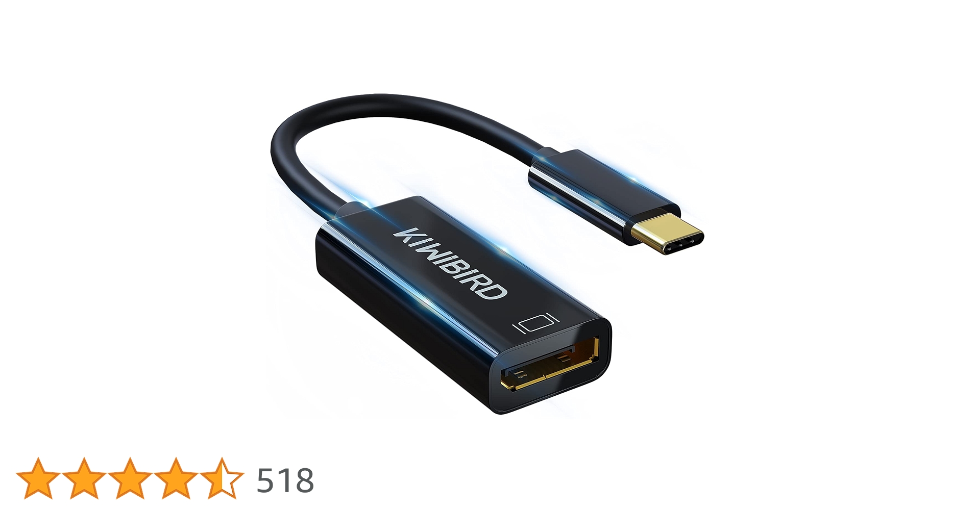

Does this mean I need to get something like one of these products to get both monitors to show at 60Hz?
Thunderbolt 3.0 to DisplayPort adapter: https://www.amazon.co.uk/dp/B01EPU7R4M/
UCB-C to DisplayPort Cable: https://www.amazon.co.uk/dp/B075V27G2R/
