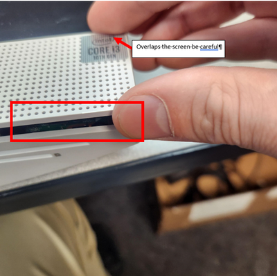

flip the unit over and take off the sound grill. This was very hard to remove but a pry tool works and it is just clipped in. Be sure to be careful because to overlaps the screen so try to stay near the bottom left or right corners so you do not damage the screen.
