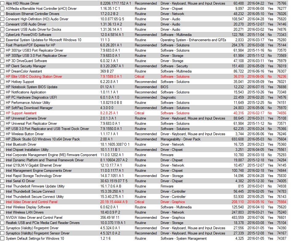

Softpaq on the "Check fo updates" screen is showing available softpaqs. I've attached a screen shot of the "Show this computer" screen as theres tons of things shown on there.

Even in my setup I see a bunch of "Latest SoftPaqs Only", which can be confusing. I can see that many of those are old drivers, so I ignore those. To maintain stability of the system for now, I pretty much only downloaded the essential ones per HP's posts that were supposed to get the dock working. I have attached a image of them for what it is worth, I see you can update your Nvidia drivers. I'll be getting into each driver one-by-one over time when I can do restore points / testing.
