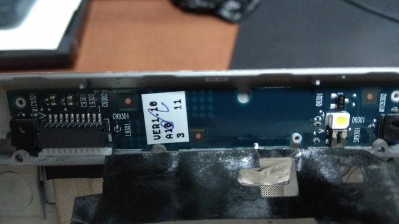

Today I got to the microphone board. It looks like this.IMG_20181010_183214.jpg
Hi.
I see you have gotten farther into the project. The module should be attached with double-sided tape and you can pull out (maybe you can use an old credit card or something similar to pry it out) and replace with the camera module.
Regards,
David
Hi, yes, I know about it. I decided to take a photo, maybe my experience would be useful to someone else) A module with a camera was used, as the price of shipping a new module is very expensive to Russia.
The module with the camera is received and installed. Everything works. Thank you all!
