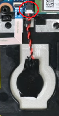

I just saw that this laptop has RTC battery. Could this be the reason? https://youtu.be/ykG7YvZSWmw
@David88100,
What do you know: your laptop does have an RTC ("Real Time Clock") aka CMOS battery -honestly, I did not expect this.
Well, then, simply disconnect the RTC battery for 15 minutes (red circle), reconnect and restart.
