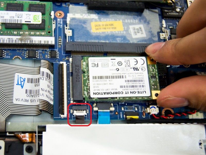

The keyboard backlight does not turn off. The backlight button on the keyboard responds (brightness changes). How to solve this problem or completely turn off the backlight physically.
000.jpgDismantled the laptop, found a backlight cable and turned it off.

Reinstalled the system, did not help. I think it’s necessary to somehow interrupt the backlight power circuit.
@KS62,
Perfect, I am really glad to hear that the issue is resolved. However, this is disable the back light permanently.

Thanks for the help, this solution suited me.
