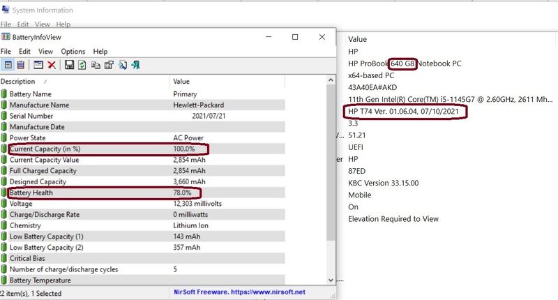

With these newer BIOS versions, HP creates a "virtual" Battery wear level of 20% (battery health is reported back as 80% minus the normal wear and tear of the battery at that time). In this way, the Fully charged capacity is reported as being much lower than the Designed charged capacity, and the BIOS reports the battery as charged to 100% (of the fake "virtual" 80% available Battery capacity). The battery icon also displays 100% in Windows.
This is a bit hard to understand, so I'll just demonstrate how it works on two of my systems, a 650G8 with its original 2020 BIOS and a 640G8 with a later one.
This is a screenshot of the Battery state of the 650G8 bought in early 2021 with a battery manufactured in late 2020. Charge level is listed as 79.5% and battery health as 99.3%.
This is the Battery state for the 640G8 bought in mid-2023 with a battery manufactured in mid-2021. Charge level is listed as 100% and battery health as 78%. Since this is a more portable laptop, I often use it on battery and this is why it has some battery wear (2%), and the larger 3-year old 650 has almost none (0.7%)

its hp x360-1040g8 with 78w battery and latest bios version. So the design capacity is almost 78000MWH. But the actual full charge capacity (without battery health saving mode) is around 62000MWH 80%. Which means that my battery's health is already 80%. When i charge my battery to 100%, the current capacity showed as around 62000MWH in normal charging mode without restriction.
Now, If I set HP power manager to (maximize my battery health), it do nothing! The battery current capacity still go to 62000MWH at 100% of charging and power manager do not reduce the full charge capacity to something lower in order to limit the charging to 80% or create a virtual wear level for health safety.
This was my query. Logically if a battery currently holding charge capacity of 62000MWH and hp power manager instructed to maximize battery health, it should reduce the capacity calculated from current full charge capacity of the battery, not from the design capacity, to protect overcharging and other related issues with the health. but unfortunately, it is calculating from designed capacity only, limit the full charge capacity to 80% of designed capacity in maximize health mode. which is not benefitial if battery's current charge capacity is already at 80%. In such case, the "maximize my battery health" mode do nothing for the battery remaining health protection.
