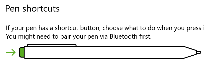

I'm still skeptical of the agents answer, though. My laptop has Windows Ink as well. I'm pretty sure my laptop says it can be connected with bluetooth to a pen, according to these images: Annotation 2020-05-25 152242.pngAnnotation 2020-05-25 163551.png
I'm still not sure whether my laptop can be used with a passive or active pen. @EddyK
