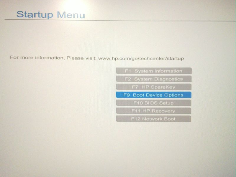

I went in the BOOT options as you may see below:
FirstFirstSecondSecondThirdThird
I selected UEFI then I rebooted; a message told me that was impossible to boot.
I had to restart my PC and this time no message on left below the screen informed me (as before in normal BOOT) what was the key to press to enter the BIOS.
At first, I was completely lost thinking about the impossibility of booting again!
I then restarted my PC and pressed the ESC key - and it worked - I entered in the BIOS settings and reenabled the BIOS legacy option that is the old setting.

As in the photos, I've attached, the only option that is enabled to be selected is the highlighted one; that is at the moment the enabled option.
It is impossible to select the SecureBoot item in the SecureBoot section so at the moment I don't know how and if the SecureBoot is enabled,

Hi,
No, Secure Boot is not enabled at the moment - based on your description and based on the pictures.
Secure Boot is indeed supported, it might be activated but at that moment now -> it is not active.
In order to restore your Windows (a.k.a. to make it boot  again), you have last enabled Legacy (CSM) mode. Secure Boot can only be functional if legacy mode is off and if UEFI mode is ON

Your PC model uses UEFI but can simulate the legacy BIOS mode (CSM). Based on the pictures and description, your PC is now configured to simulate Legacy Mode (a.k.a BIOS mode). Secure Boot cannot operate and exist while in BIOS mode.
You have reinstalled (restored) Windows while Secure Boot was off and while UEFI was off, too.
  • Therefore, it may be hard or impossible to re-activate Secure Boot now - without additional Windows reinstallation (restoration).
  • In order to re-enable Secure Boot, you may need to (1) enable UEFI Mode, (2) activate Secure Boot in the BIOS/UEFI/F10 - it will then become active option not greyed out, and then (3) reinstall Windows while the above mentioned modes are ON.
  • Windows reinstallation may be needed because to change the boot mode from legacy/CSM to UEFI, you will have to convert your OS HDD drive from MBR to GPT scheme  >> https://superuser.com/questions/739153/uefi-with-mbr-partition-table
All of this is not worth it due to all the hassle.  In my opinion Secure Boot will not make you much more protected. Best would be to leave as it is now - in Legacy mode and enjoy it
