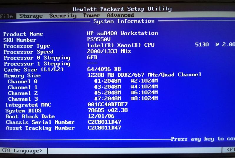

xw8400
CPU:             1x5130  ( must upgrade to 2x X5365)
RAM:            32GB DDR2
BIOS:            updated to 786D5 v02.38 (hopefully that's the latest version)
HD:               Raid0 with 2x Crucial SSD
GPU:             Nvidia GeForce 770
OS :              Windows 10 latest version
Which of the 2 workstations do you think is worth upgrading with the latest supported CPU and new GPU so i can turn it into a gaming PC ? My sweet spot is for the xw8400

xw8400 is fine win10 installed without any errors

Can anyone please verify my findings:
*z400 max CPU is the X5690 and the system goes up to 16gb of DDR3
*xw8400 max dual CPU is X5365  ( already have 32gb of ram )
What Nvidia GPU do you recommend for each workstation so i will not bottleneck the CPU ? i was thinking something like the 970, 1050 or 1660. What is the absolute max ?
I will come back with eBay links showing the upgraded parts i would like to buy so you can help me verify they are compatible.
Thank You
