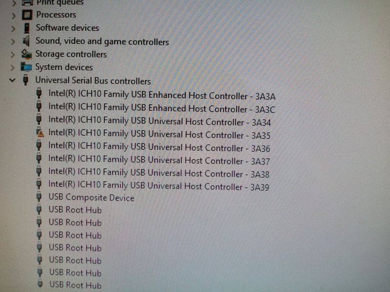

I will post a screenshot of the error i am getting on the device manager and also my shopping list to verify everything is in order

That error code will go away with a proper HP factory install or W10. If you have a HP OEM COA W7Pro64 you likely can still get W10Pro64 install for free. I can. I'd start with the W7Pro64 HP OEM COA build, update it properly, and then do a W10 upgrade atop that (rather than a clean W10 install). That tends to get the right W10 load from MS versus a clean install from zero for these tricky issues.
