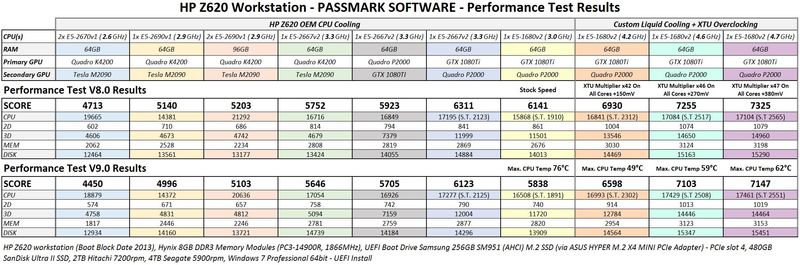

For audio recording, your 2 primary objectives are; lowest possible audio latency, and low system (computer) noise, e.g. fans and mechanical drives. I use Cubase, Sony SoundForge and very occasionaly, FL Studio. With regards to out-of-the-box performance (i.e. no overclocking), the E5-2667 v2 is easily one of the fastest CPU's in terms of single threaded performance;
E5-1680 v2 = 1908 - 8 core
E5-2690 v2 = 1771* - 10 core
E5-2667 v2 = 2125 - 8 core
* The 2690 v2 score is from the Passmark website, the other 2 results are from testing on my own Z620 system, see below;
(Click the image above to view full screen)
Even with multiple very large virtual instruments (Ivory Grand, Spitfire libraries) and FX plugins loaded in Cubase, only about 14GB of RAM was used. Most sample based programs now run DfD (Direct form Disk). As a minimum, I would recommend 32GB (4x 8GB) of 1866MHz RAM. If needed (after checking windows performance graphs), you could easily add more RAM later if needed.
Ideally, you also want to be using fast (and quiet) SSD drives, and better still, have seperate drives for the audio files and OS/programs. Depending on your budget, you could also consider a PCIe M.2 drive for super fast read/write speeds. Stick to using mechanical HDD's for backing up and archiving only. Please also note that there can be major differences in read/write speeds between the different SATA3 SSD manufacturers and models available, so check before you buy. The SanDisk Ultra SSD drives are excellent in this regard.
HP Z620 - Liquid Cooled E5-1680v2 @4.7GHz / 64GB Hynix PC3-14900R 1866MHz / GTX1080Ti FE 11GB / Quadro P2000 5GB / Samsung 256GB PCIe M.2 256GB AHCI / Passmark 9.0 Rating = 7147 / CPU 17461 / 2D 1019 / 3D 14464 / Mem 3153 / Disk 15451 / Single Threaded 2551
Thanks heaps for the reply BambiBoomZ,
I was aware there were some performance disadvantages with the 26XX series in a single configuration, compared to the 16XX counterparts, but I wasn't sure where exactly they were .
You compare the performance of the multi-cpu series using Reg RAM with a single configuration CPU with unbuffered. So what about both on Registered? Am I right to consider this comparison? What are the things to consider when using registered RAM instead of the unbuffered?
I see you are using the Z420 Liquid cooler also. So those figures should be attainable for my own application. Although I'm on Win 10 Pro instead. I did read a thread regarding XTU compatibility with Win 10, on here, but I think that user got it resolved eventually? I did have issues with later versions of XTU when I installed (just to test it) but I found a version the I think Brian1965 was using; 5.2.0.19 or something? And that runs fine on Win 10 Pro, despite being intended for Win 7.

MaxxCobra,
As for the RAM type, re: unbuffered or registered, the difference- a couple of ms here and there, will be only noticeable in benchmarks rather than in use. Both the office z620_2 and z420_3 are using 64GB (8X 8GB) of HP-labeled Samsung DDR3-1866 ECC Registered. These modules were rotated out of Proliant servers on a typically conservative hours in service basis and have had excellent reliability. Of all the ex-server modules ever used in an office system: HP z420_1, z420_2, z420_3, of which all had 3D CAD and rendering use, one had a persistent memory training issue but no module ever failed in use. These modules are also less expensive than unbuffered.
Of the 33, z420 and z630 using the E5-1680 v2, 14 are Windows 10 and only one appears to be overclocked to 4.1GHz. The version of XTU does matter; the V. 5.20.14 that Brian1965 and I use was the result of a lot of tries. Whether that version will be compatible with W10 is unknown, but O/C is a matter of tuning parameters in BIOS, not Windows. The fact that the V. 5.20.14 microcode is more nearly contemporaneous to the E5-1680 v2 and the associated BIOS may well be key.
Yes, improved cooling is essential to increase the Turbo clock speeds. The z420 AIO liquid cooler is a good design: quite effective and very reliable. I was never able to achieve more than 4.3Ghz. I do have an Alphacool Eiswand external tower cooler:
