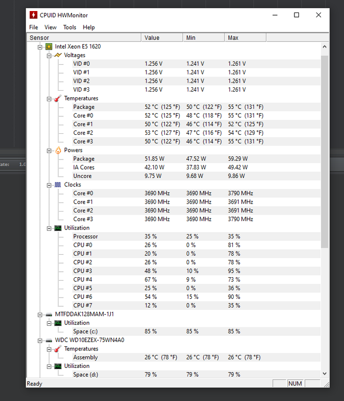

Here is some data from HW Monitor, one with just the DAW running, and the other with an offending 'Amp Sim' (Bias FX 2) running on an intensive preset.
In both scenarios I've got anit-virus running etc.
Here is just the DAW (Reaper) running alone;
Reaper. Win 10. E5-1620 0Reaper. Win 10. E5-1620 0

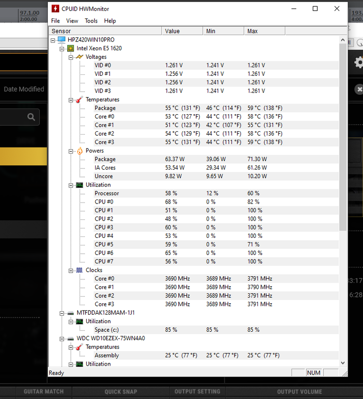

And here is Reaper running with Bias FX 2 'Amp Sim' VST;
Reaper. Win 10.  Bias FX 2 VST. E5-1620 0Reaper. Win 10. Bias FX 2 VST. E5-1620 0

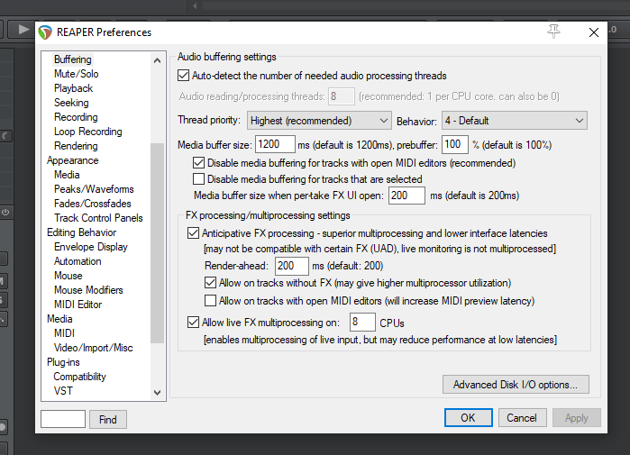

Here is another view of the core settings within Reaper. This time is a shot of my own settings. Please see the setting at the bottom where you have the choice to set cores for 'Live FX Multiprocessing'. This is a crucial consideration I believe as it implies more cores would have an effect on live processing of input recording... and in my situation, of Guitar amp sim live recording. How effective this setting is, who knows??
Reaper CPU Core SettingsReaper CPU Core Settings
