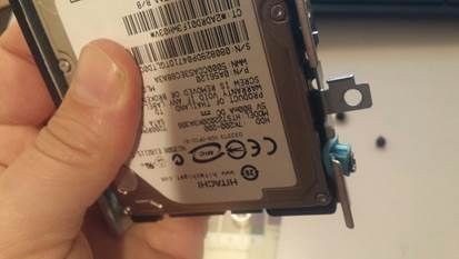

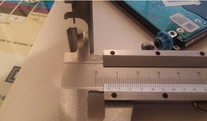

Following the manual i easily removed the hdd drive caddy but is impossible install new hard disk becuse there are no mountig screws. There is need of particular 2.5 hdd grommet screws the perfectly feet into the caddy.
I asked to mu supplier (HP gold partner)  and initially he give me same screws with correct threading but diameter of grommet too big and finally he answered to me that the screws are unoptainable.
The number stamped on the caddy is: 13P1-5KN0G01-00 REV.A.

i looked at the pictures provided in the link you provided and i can offer a 3rd method for installing a ssd in the carrier
get the correct threaded screws for your drive, and if two long cut them down to the correct lenght then wrap the threads with electrical tape till they are the correct size to fit in the slot without much movement
if you are using a normal HD i suspect all nessary parts can be found in a well stocked hardware store
screws/washers,rubber washer,round tubing to place over screw threads
