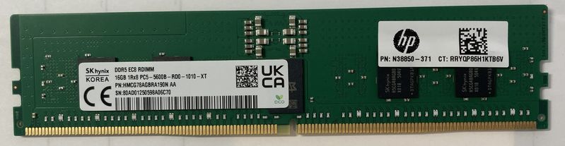

Note that the front right side HP label includes not only the Assembly P/N but also the Option P/N... I hope that HP keeps doing that... makes my searches easier. Please do me a favor and when you get your Z6 G5 workstation post a picture of the front of the single memory stick that it comes with. If that takes you two hours or less to do, then we're even.

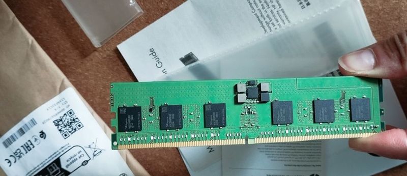

Hi SDH. I got an email notice of a pm today, but I'm now at G-Windoze1 (I lost access to G-Windoze somehow). So couldn't read it. Anyway, I finally got my Z6-G5 workstation with a single 16GB stick (picture attached, as requested!). I then ordered and installed 4 SKhynix 16GB sticks from Server Supply 1 photo below), and I've booted it up. But have not ported my previous workstation over yet - too busy planning an upcoming trip.

1 of 4 new 16GB sticks purchased1 of 4 new 16GB sticks purchased
Original 16GB stickOriginal 16GB stick
