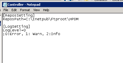

"Failed to login" usually indicate that your HPDM Repository configuration is not correct. To confirm this, I need a screenshot of your Master Repository Editor dialog and the Controller.conf in ..\HP Device Manager\MasterRepositoryController\Controller.conf.

Here are the screen shots you asked for, first the Master Repository Editior screen, then the successful test, then the Controller.conf.
I am taking over this position from a previous admin no longer with the company, the settings for the Master Repsoitory Editor - Repository Name (no change), Server Address IP (No Change)  FTP Protocol Settings and Shared Folder Protocol Settings used the previous Admin's Active Directory Credentials.  A new credential was created that was not tied to an individual, which works for the Shared Folder Settings, but does not work for the FTP Protocol Settings.
