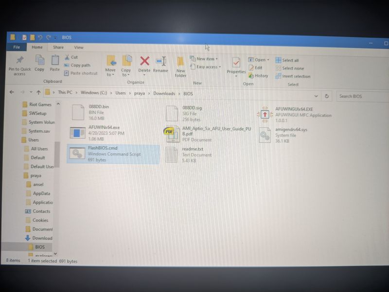

PXL_20230420_224500540.jpg@mike
Bro is my laptop cursed or what?🙂😭😭 I copied bios file and utility file in one folder and also copied that Flashbios.cmd file in that
But when i try to open it as administrator it open and then closes instantly... When i remove AFUWINx64.exe it shows AFUWINx64.exe missing. But when i again copy afu file to that folder it closes instantly.😭😭 Mike bro pls help me out my laptop is burning like lava after bios update.. i will even pay you maybe i will take some time to  pay because i am still a student 🙂 but i will surely pay you... Can't you arrange a video call so that i can show you what i am facing.
