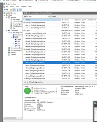

The firmware F.57 was installed via Windows Update  servers and not via WSUS and as I said originally it was a Windows 10 Optional Update.
I have an office with 37 identical models, and I have only applied this one optional update to  10 computers

Looking at one of the computers, which is still BIOS version  F.55, the EFI HP BIOS updater utility says it looked for a. signature file type  s12 for the current version F.54, but the file did not exist, and it skipped past this rather than hitting and error and stopping the update.
So now I am puzzled why the HP Diagnostics Untility ( F2) cannot do a BIOS rollback and says it cannot open the file signature ( .sig  and missing  .s12) for version F.55 and trying to trick it  gave the message " The BIOS Image did not pass signature validation (Security Violation) "
