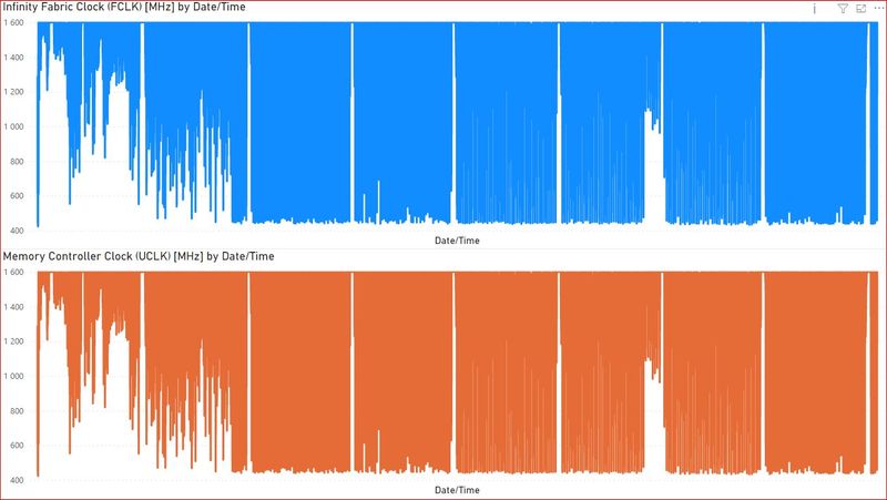

The only interesting thing I think I found is the flappy FCLK and UCLK. This chart is taken over 3 days period where the PC was plotting Chia on a NAS.  It was taken by HWiNFO64's logging of the system and then some Power BI for the chart itself.FCLK_UCLK.JPG
Mem multiplier and memory clock were fine, at least according to the log. No errors or throttling either. Temps and voltages were also seemingly in check.
Let me know if you want me to upload the whole log.
