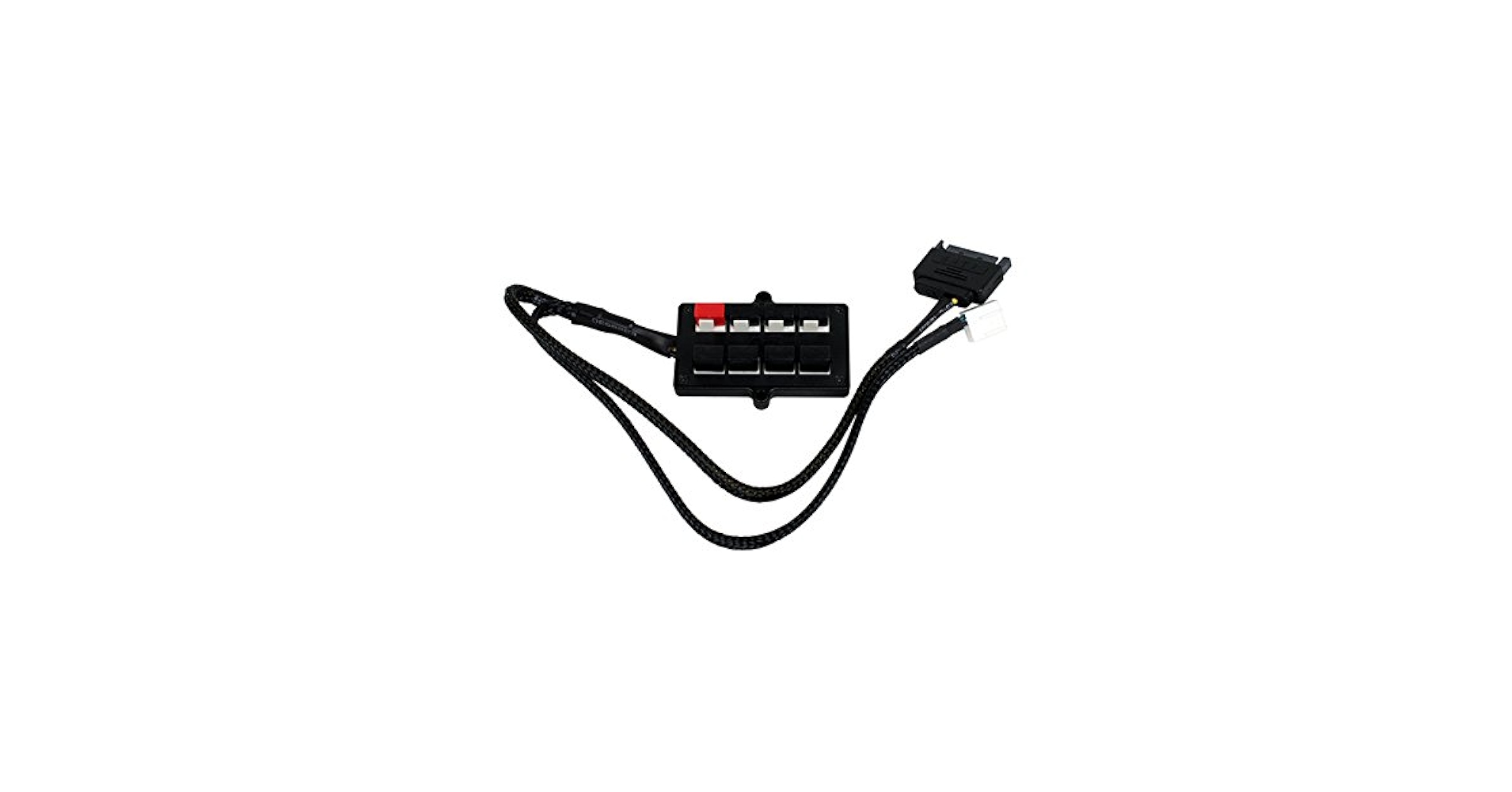

04-13-2019 07:28 AM
Thanx SDH for all the information provided. I accepted it as a solution.
I like to add another way(workaround).
Using a PWM signal splitter like this one
https://www.amazon.com/Swiftech-8W-PWM-SPL-ST-Way-PWM-Splitter-Sata/dp/B00IF6R4C8
Plug it in the case fan header and all the other fans will be controlled by this header
