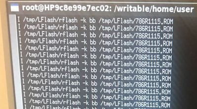

05-18-2017 05:06 AM - edited 05-18-2017 06:44 AM
I could not update it.
LFlash folder; I copied it to the / tmp directory.
later; I wrote chmod + / tmp / LFlash / rflash with xterm.
Gave an error about permissions.
Then this error is fixed, but yes I /tmp/LFlash/rflash -k bb /tmp/Lflash /786R1115.ROM
The command repeats itself when I write this command.
The screen does not display a different image.
Later
