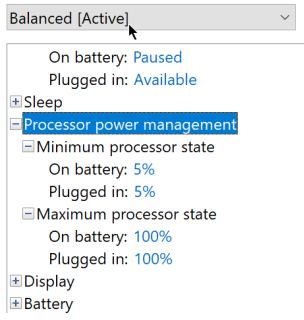

I use %99 for CPU Performance myself:  It keeps the CPU out of turbo speed which make a huge difference and no need to download 3rd party software.
Enter the phrase 'edit power plan' in the window search box
Then select the 'Advanced' tab
To keep the CPU from overheating , consider
using %99 instead of %100.

Try to keep it under 100c. I recommend the %99 setting to disable turbo.
If it still overheats (100+) with turbo disabled return it for warranty work or add (or fix) the water cooling problem.
