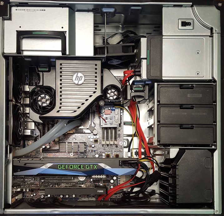

The HP Z620 workstations support full height / full length PCIe cards (with extenders). If you look closely at the internals of the Z620 you will see the PCIe card guides on the back of the front case fan enclosure (RHS).
However, please be carefull of some of the newer gaming variants of the RTX/GTX range as some of those cards do not conform to the PCIe standards in terms of height. Specifically, be carefull of cards that have multiple fans and are generally fitted on OC'd or performance / gaming variants as some of these cards are quite tall and will interfere with the Z620 side panel closing. Personally, I stick with the single fan / Founders Editions of the cards as these will easily fit in the Z620 and can even be upgraded for water / liquid cooling if necessary. The FE variants occupy 2 PCIe slot widths but most of the gaming / OC'd variants will occupy 2.5 or 3 slot widths.

I second Brian1965 comments as to using blower-style GPU's in a workstation when possible. As far as I know, all Quadros and Firepros use a blower fan. Workstation cases are made to run quietly and don't have the high airflow afforded by multiple large, surface mounted fans. Typically, the Founder's Edition and some vendors' variants have a single blower fan that exhausts the warm air through the back panel of the case rather than warning the interior and thereby adding to the CPU temperature. I'm quite certain this pattern will continue in the new RTX Supers.
Personally, I'm waiting for used Quadro RTX 4000's to be $600, so I have a year or so.
BambiBoomZ
HP z620_2 (2017) (R7) > Xeon E5-1680 v2 (8-core@ 4.3GHz) / z420 Liquid Cooling / 64GB DDR3-1866 ECC Reg / GTX 1070 Ti 8GB / HP Z Turbo Drive M.2 256GB AHCI + Samsung 970 EVO M.2 NVMe 500GB + HGST 7K6000 4TB / Focusrite Scarlett 2i4 sound interface + 2X Mackie MR824 / 825W PSU > HP OEM Windows 7 Prof.’l 64-bit > 2X Dell Ultrasharp U2715H (2560 X 1440)
