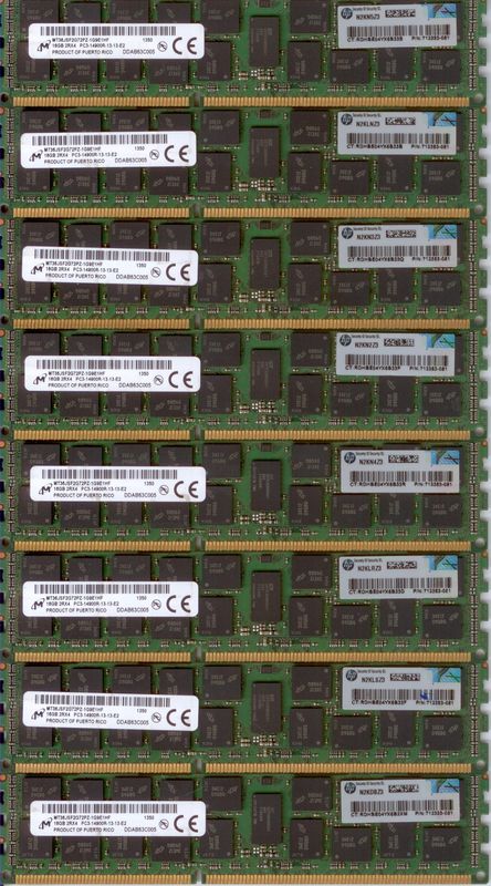

The pictures below show exactly what I used in a Z600 v2 workstation with two of the same processors you have, and they worked fine. Note they are dual rank... maybe that is why they worked so well. DGrove's attached link on Z800 points to quad rank memory being throttled to 800 MHz.
This is the same memory that also can run fine at full 1866 speed in our Z420 Z620 souped up workstations with single 1866 MHz processor in place for either, usually a E5-1660 v2.  EDIT:  We only have tested with the v2 revision of the ZX00 and ZX20 workstations... never wanted a v1 so never had one to test with.

Good to know... hey, D, does a 16GB dual rank stick like I show in the pics draw less power from the motherboard than a 16GB quad rank stick? I wish I had a Z800 v2 to test with, but we've moved on by several generations now.
However, at home I still am running a souped up Z400 and Z600 just for the fun of it. Surprisingly fast performers with W11 22H2 loaded.
it's not really a power issue,....... a dual 16gb dimm will draw about the same as a quad rank
what's important is how the dimms memory chip is organized  dual rank in most cases works out best in regards to the load placed on a memory buss by a dimm and the latency of said dimm
https://www.crucial.com/support/articles-faq-memory/what-is-a-memory-rank
