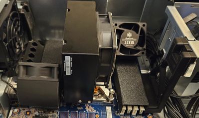

And there it is: Custom memory cooler for the Z440
First series of tests are running but they seem to work quite nicely. They are detachable by using the stock mounting points and mechanism.
It took me around 9 hours to construct and print them. The 2 fans are Silverstone FTF 6025 PWMs. They are absolutely silent when the case is closed. 🙂

Nice work again with your 3-D printer... the vertical side add-on mounts that clip into the front and rear metal attachment slits are not shown individually but are pretty clear on your final pics after assembly. Did you use super-glue to bond them to your horizontal over-the-ram parts?
