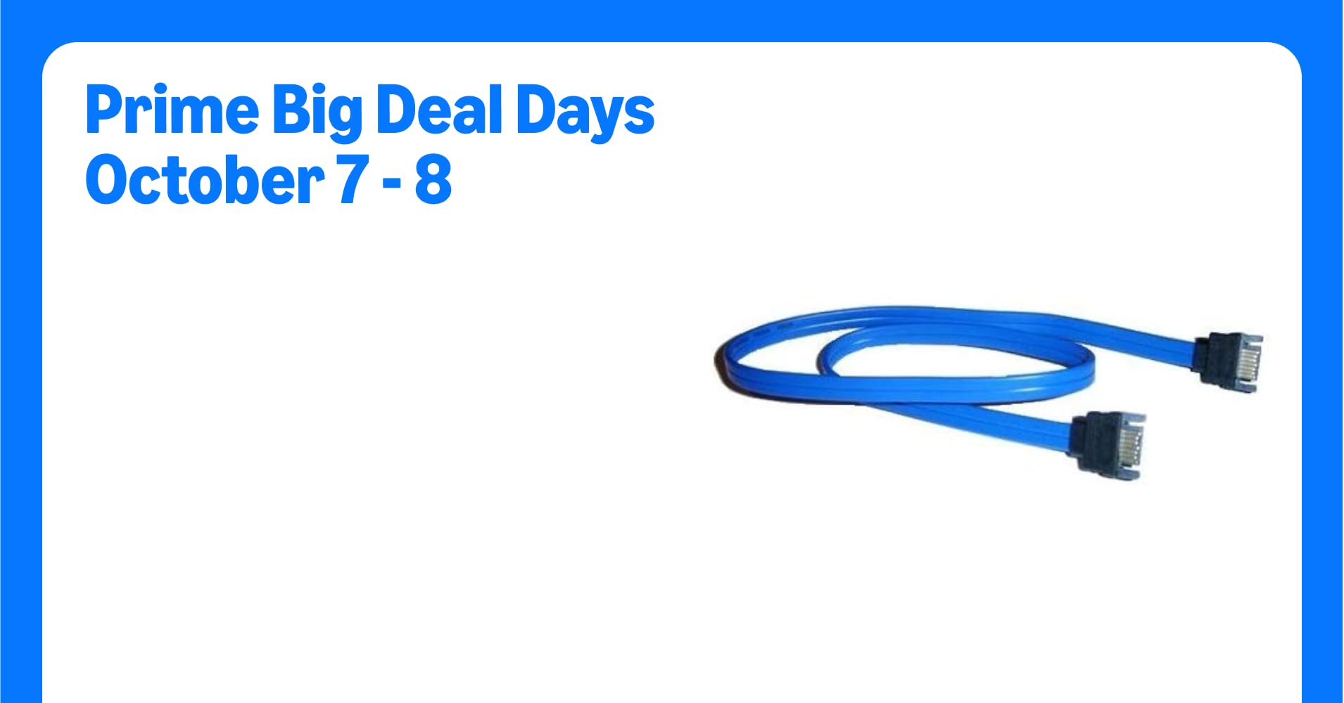

simple use 4 of these (order spares!!)
https://www.amazon.com/SATA-Cable-Male-Connections-Pin/dp/B002P6Y4HC
and the correct (FORWARD) cable for the raid card 6805 uses a forward type not reverse!!

Thanks for the reply, but I am totally confused
The individual cables you quote are male to male, but as I would be extending an existing cable, surely I would need a male to female.
The 6805 card seems to have two multiport SAS connectors and cables, so how would I connect these to four SATA cables

not that hard,...... look at the 4 sas/sata cables from the drive bay that connect to the motherboard note it's a FEMALE one, the motherboards sata plugs are MALE
look at a SFF-xxxx SAS/SATA cable note that at the 4 cables sata/sas end again they end in a FEMALE one
(Look at a SAS/SATA drive, note the drive connectors are MALE)
either of two sata cables listed above will connect to the Hard drive male plug, but to connect the raid card end to the z800 cables you require a male to male adapter
again,....to connect the raid cards four FEMALE ends to the z800 drive bay's four FEMALE plugs you need four male to male adapters

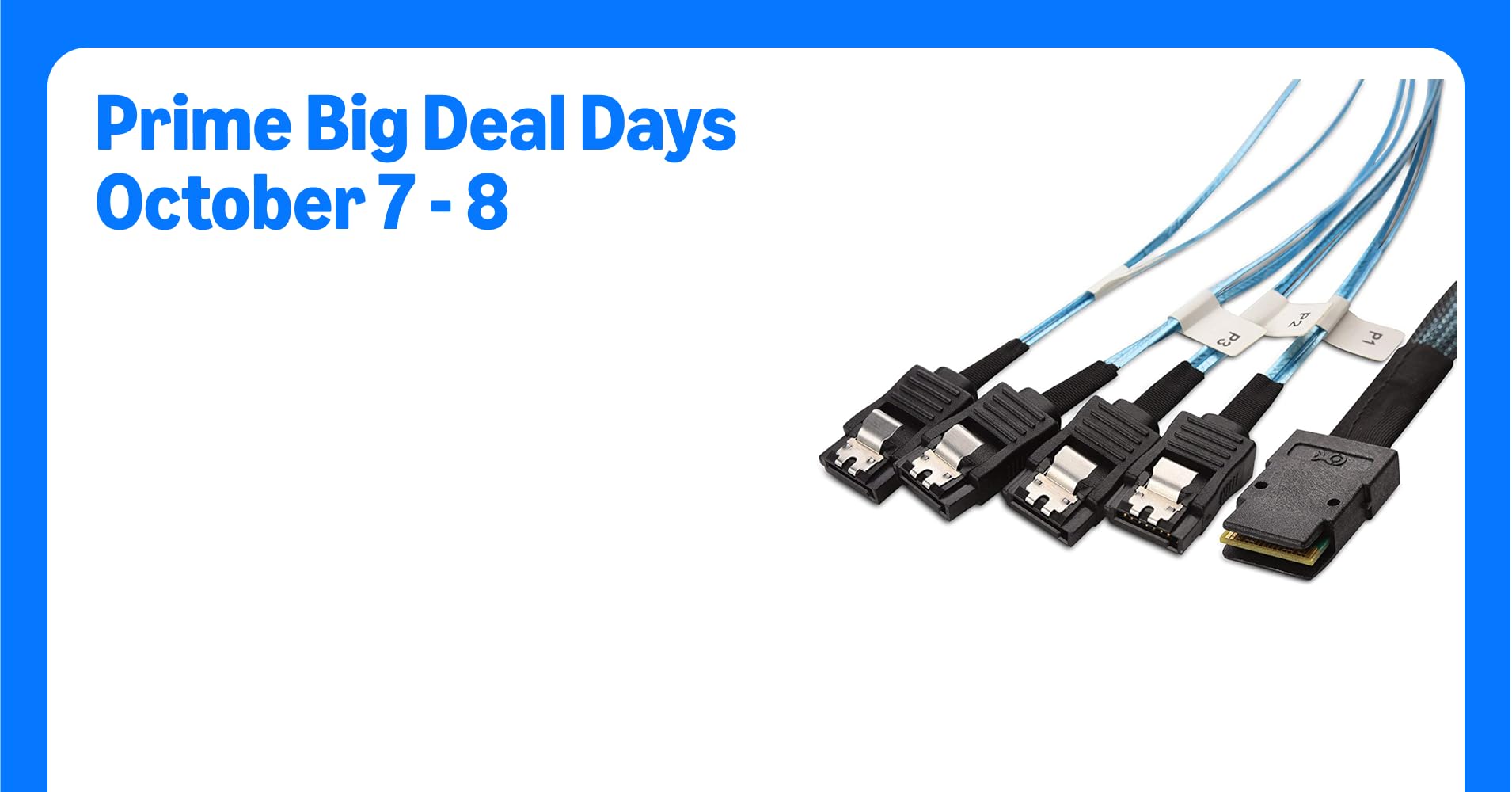

If I were to buy the 6805 card then am I correct in thinking that this is the cable I would need
https://www.amazon.com/Cable-Matters-Internal-SFF-8087-Breakout/dp/B018YHS8BS/
But this appears to be female, so I still need the male to male cables ?

last the cablematters you linked is the correct one for the 6805 series, and you will need two cable sets
the 71605 uses a mini sas sff- xxxx connector rather than the std sized sas connector the 6805 uses
