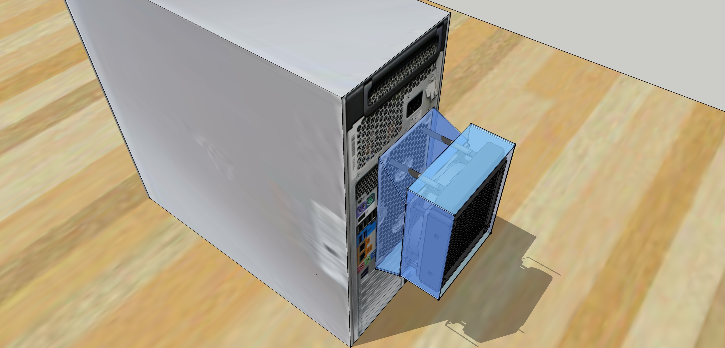

Here's a more feasible design using an external, extended plexi mounting for a single 120mm fan unit that doesn't obstruct the PCIe rear slot covers:
This is feasible as it would effecively extract from the entire rear panel openings in addition to the two 92mm case fans. Fabrication from 1/16" plexi should not be terribly difficult. The mounting panel is not shown in this model, which uses the same holes as the case mounting.
