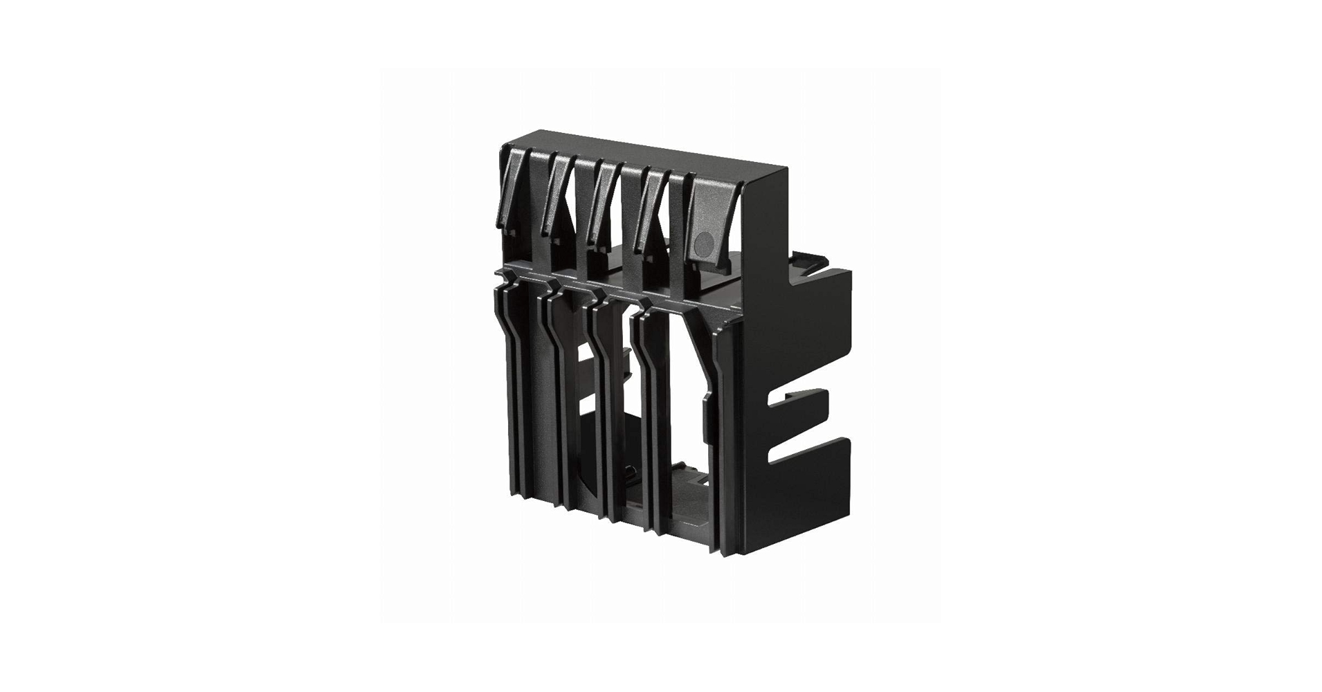

He told you what to get... that is the HP "option" part number for the correct whole kit.
For years now these front lower case cooling fan "kits" have been comprised of a HP-selected correct fan and the correct custom fitting black plastic PCI card guide/fan mount cage. Up at the front lower part of the motherboard will be a fan header to plug that fan into, currently unused in your situation. Everyone in the forum will now know this is what to get. I'd advise putting one in any of these workstations at the low price noted below whether it demands it or not. They are quiet and cool your case better over the long haul.
Look at THIS eBay ad for exactly what you need. It is a HP kit with correct fan and fan mount cage. 20.00 USD. This is exactly what I'd buy if I was you, especially at that low price for the whole kit.
EDIT: That fan measures 92x25 mm, and from the ad you can see the HP part number on the fan's label. You need more than just the fan... that black cage it snaps into is key. Those cages have tabs at the bottom to fit into holes already built into the case, and then you rotate the cage up to lock into position. It can be a tight fit... work carefully. Plug the fan in as your last step. Computer fans always blow towards their label, and you want this fan to blow into the case. Face the label towards the rear of the case when you snap it into the cage (facing towards the PCIe card guide slots).
Note that on the fan's label there is the main Foxconn part number and also the HP part number. Note the small added "modifier" alphanumeric by the Foxconn number... those detail the fan wire length and plug type for your kit's needs. That same Foxconn fan might be used elsewhere, with different length and types of wires and plug ends. There also usually is a cage part number embossed into the black plastic of the cage. You can't do better than getting a whole brand-new kit because everything will be correct that way.

Regarding the YouTube video... that is for a Z4 G4... the concepts will be the same but the space will be a bit smaller to work in.

for those that don't want to search for the parts separately here's the complete kit you need
HP Z2 G4 Tower Front Card Guide and Fan Kit, part# 4KY82AA

The Amazon link DGroves gave in good faith above is for a different workstation, the Z4 G4. The kit for that won't fit for you. Here is a translation of the single Amazon review for that listed item (it is described incorrectly by the seller on Amazon):
"1.0 out of 5 stars Incorrect product
Reviewed in Italy on February 5, 2021
The accessory is for an HP Z4 Workstation, not Z2!!!"
HP provides an option part number of 1XM33AA for that Z4 G4 product, shown at B&HPhoto HERE. Don't buy that one.

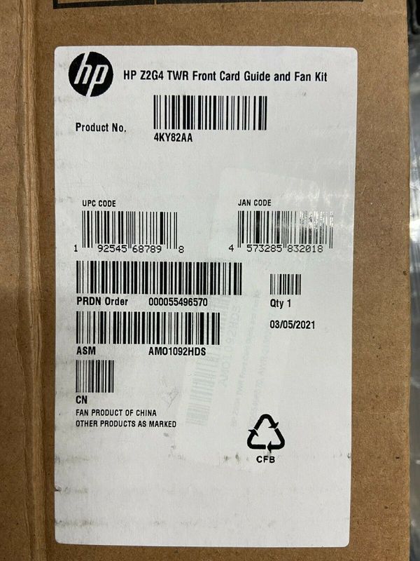

You want the Z2 G4 item, and here is the shipping label for the correct product from that eBay I linked to:
Thank you! I had noticed all of the results from my Google searching was returning parts for the Z4. I was beginning to wonder if I could find the part.
I followed your advice and purchased the one from your Ebay link. Thanks again for your post!
