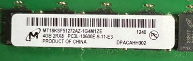

I have five DIMMs because it came with four (4 x 4GB) and I bought another one of the same make, spec., and with exactly the same latency, etc., codes.  (When I find another one I’ll buy a sixth.)  Photos as requested but they’re not very interesting!
38A4D85F-CCF9-45D4-A9DE-BE9DB8461E37.jpeg56E56706-54E2-4E3C-89E3-B62B1503E772.jpeg4296B568-3611-4A90-BF3B-58B85E9A0DCE.jpeg7B7BDA02-3885-4035-A881-A585100CEBEF.jpeg09BBF328-4646-4E5B-8E92-C7EFA6977FD0.jpeg
the 4 picts of dimms are  dual rank (2Rx8) and 10600E is unbuffered ECC memory, with timings of 9-11 this is a fairly common spec module
while it's highly recommended to match modules, in practice you can use different memory makers modules as long as the actual specs like rank/size/timings match also you can use different spec modules without issue as long as the different modules are installed in separate memory banks
the z420 v2 has 6 dimm slots divided into two memory banks so you could put micron in one bank and kingston in the sec bank, the system will detect the slowest dimms and clock all dimms to that speed

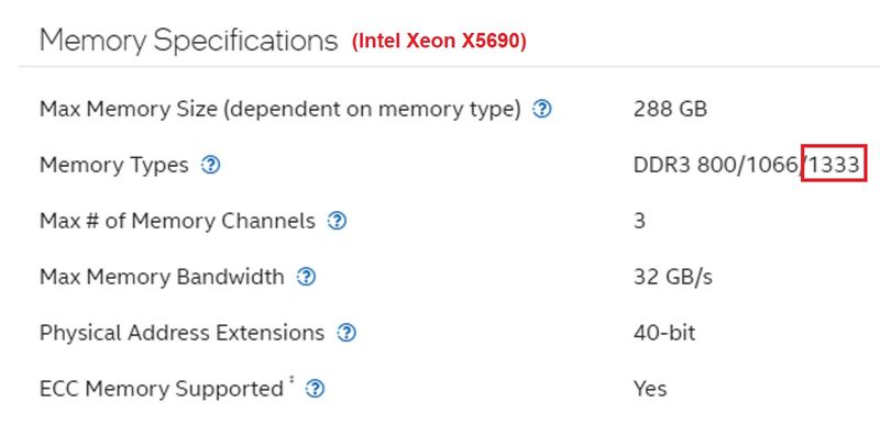

That 1333 MHz (PC3-10600E ECC unbuffered) is the fastest your Z400 v2 can ever run assuming you have an installed processor that can run that fast. If your processor supports only slower memory it will throttle back your fast memory to a slower speed. In case you were wondering that one stick with "1240" instead of "1214" just means it was made in week 40 of 2012. Since it looks like you're likely headed to buying a new used motherboard you'll have everything apart so now is a good time to think about upgrading your processor depending on what you have currently, which is what?
I ended up using a processor that is not on the official HP list of supported processors, but which works fine... the Intel Xeon X5690. It has only one sSPEC code so is easy to search eBay for (SLBVX), and a good seller from China has a bunch of those going for about 40.00 USD currently, free shipping. I use the original version of the Noctua thermal paste (NT-H1) because it spreads so well and is non-conductive, and has worked very well for years now.
Other upgrades to consider would be adding in one of the HP Texas Instruments-based "2x2" PCIe cards I've posted about HERE  and HERE  to get you 4 total USB3 ports (2 front and 2 rear). Also, you could upgrade your W10  the latest W11 (I posted on page 2, HERE ,  about my "hybrid" method, and Paul Tikkanen also has a Rufus-based method). That is the workstation I'm typing on right now in our library at home.
Here's some pics related to that processor, and good luck on your project. Keep us updated!
Fastest memory the Z400 v2 can runFastest memory the Z400 v2 can runThe processor we've used in all Z400 v2 upgradesThe processor we've used in all Z400 v2 upgradesThe X5690 only has 1 version... some have 2 or rarely 3The X5690 only has 1 version... some have 2 or rarely 3
