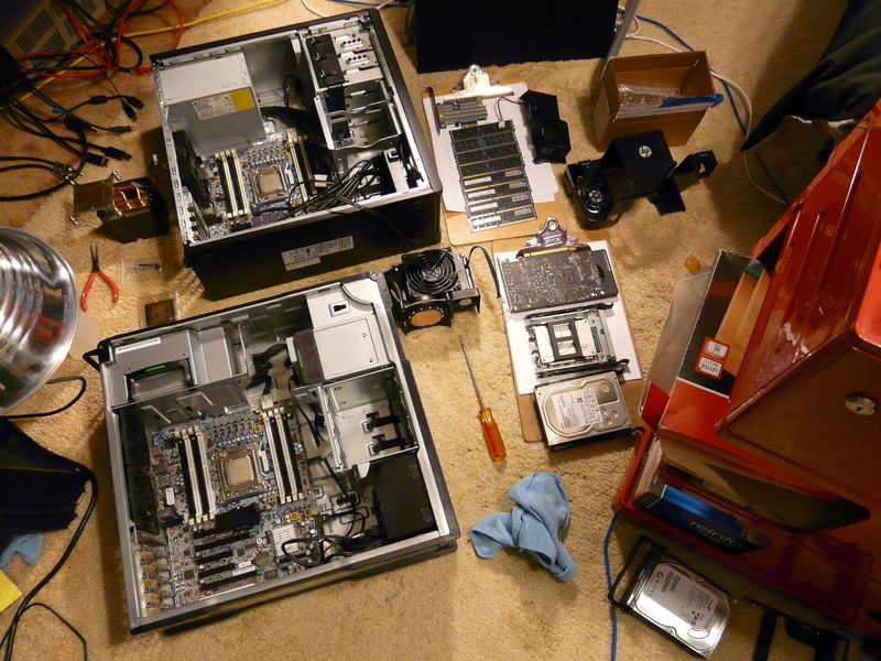

 Notice the HP z420 liquid cooler in the center, which is recommended to all z420 v2 and single CPU z620 CAD systems. the E5-1680 v2 @4.3GHz idles at 30-33C.
That process is stressful and not a productive use of time, but at least I had a system that as it shared the same BIOS could receive every part and run off the same drive. That is to reiterate the need for fast and easy transitions system to system in a professional enviroment.
