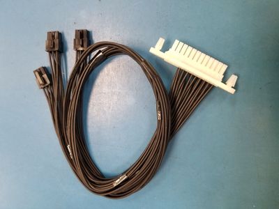

Looking at the pinout of the power supply, primarily the middle grouping where the 3x 6 pin pci slots into, I noticed that it has available power across all 24 pins yet 18 are used. Power requirements are within spec so my question is, what is stopping me from adding another 6 pin pci power rail to the back of the case to make it 4 total leads? Does anyone have a schematic of the 1125w power supply or has anyone done this before? Seems like the entire bottom row is ground and top is solid +12v for the entire 24 pin plug. It seems like how built this into their systems for future upgradability, but never gave the option for it so it's been sitting dormant. Not trying to catch anything on fire but this could be a game changer for more pci power. Thoughts?
