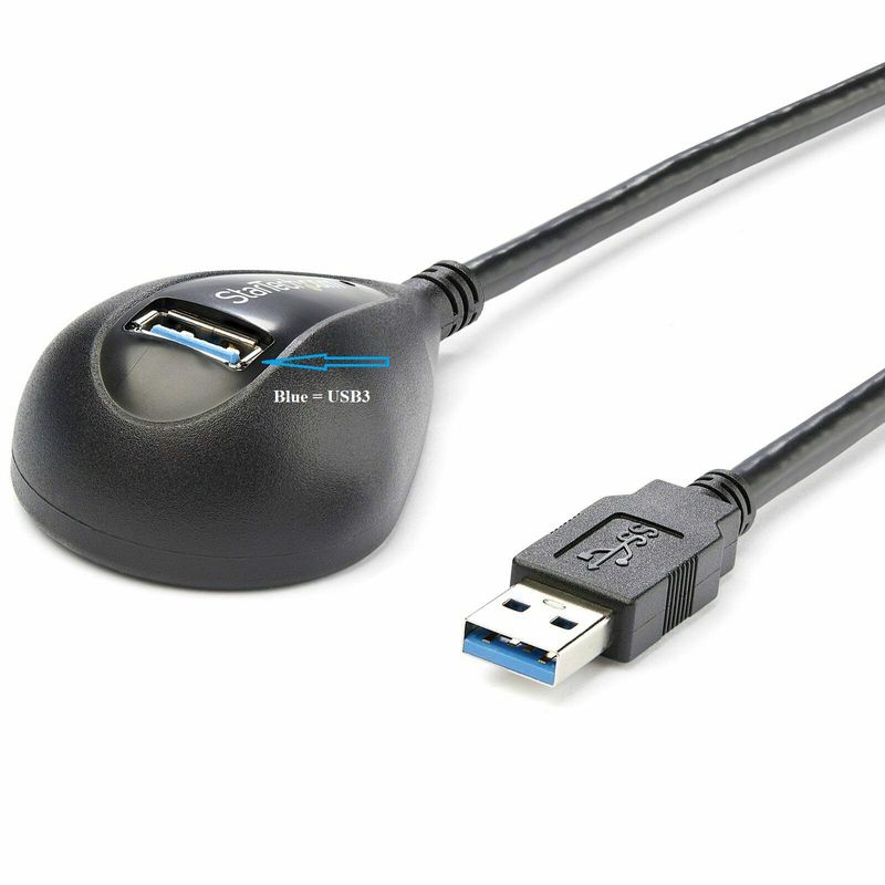

As you know there are 4 versions of the Elite 8300, the Ultra-Slim, the Small Form Factor, the MicroTower, and the Convertable MiniTower.  I'll assume yours is the SFF or the CMT, and the MT also uses the same motherboard, so the USB ports on those 3 are all the same.
A good source of info is the HP QuickSpecs for this, and the latest one you can find is best.  There is a v20 one here:
https://shop.itema-pg.com/userfiles/editor/file/HPCompaqElite8300BusinessPCDec2012.pdf   and a service manual:
http://h10032.www1.hp.com/ctg/Manual/c03612798.pdf
On the front there are 4 USB2 ports, slower.  On the rear there are 4 USB3 ports, faster with more power output possible.  There also are 2 added USB2 ports on the rear.  Blue plastic inside the port equals USB3; black or white equals USB2.  You can bring a USB3 extension forward from one of your USB3 ports to get easy access to the higher USB3 speed and power if you would use that.  I like the black USB3 version (with blue plastic inside the single port) from StarTech (USB3SEXT5DKB) but they also make a fully blue USB3 version (USB3SEXT5DSK).  Make sure you get the USB3 version if you go black because there is an old all-black USB2 version with no blue plastic inside the port.  The all-blue version is only USB3.  You also could add a powered USB3 hub to bring multiple USB3 ports out front.... USB3 is so much faster than USB2 that if you use USB much it is well worth having in easy reach.  Anker makes some excellent powered hub ones....  At least consider one of those single port StarTech versions:
