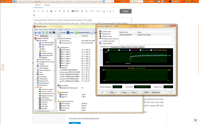

I have overcklock 1650v2 to 4.3 GHz all threads without increase CPU voltage.
Screen Shot 10-20-18 at 06.39 PM 002.PNGScreen Shot 10-20-18 at 06.39 PM 001.PNG
With 4.4GHz i have reboot during XTU benchmark even with +100mV, but CPU pass other cpu test programs, but also reboot during default win7 performance test)

Also i need to say, that when i jumped from v5 XTU to last one, i have problem with not stable overcklock even at 3.7GHz. And deleting reinstalling old versions, cleaneng with Ccleaner not helped((
Somehow i get it back to normal work after numerous installing and uninstalling throw Revo Uninstaller Pro, but without working watchdog. To get watchdog back i tried again instal uninstall different versions without luck, but installing intel WDT driver solve the problem.
Forgot to mention that, at beginning v5.2 XTU have strange bug, it is seems overcklocked fine, but when i run Aida64 - FPU Julia test i have reboot even at 4.0GHz, and stable test pass at 3.9GHz. XTU 5.2 have been installed at fresh installed windows7x64.
