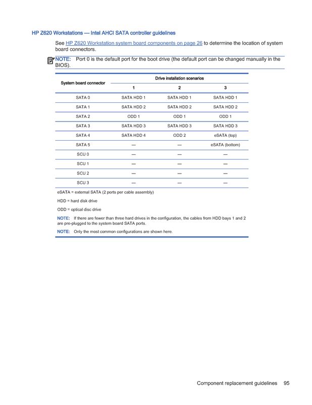

I had read the maintenance c_04205252.pdf, but that made me want to make sure I would be getting the 6Mbit sata on the drives I wanted to be as fast as possible, but I could not be sure where those were. I had hoped it would be in the 3.5 inch bays. I guess I was looking for some confirmation that was the case without trying to figure out how to trace the cabling on the side opposite the removable cover.mntncg_04205252_sata.jpg

According to the first jpg from that manual which is kind of hard to see unless enlarged, the first four SATA ports on the left are 3Mbits, the two on the right are 6Mbits and AHCI.
