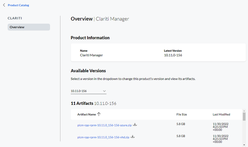

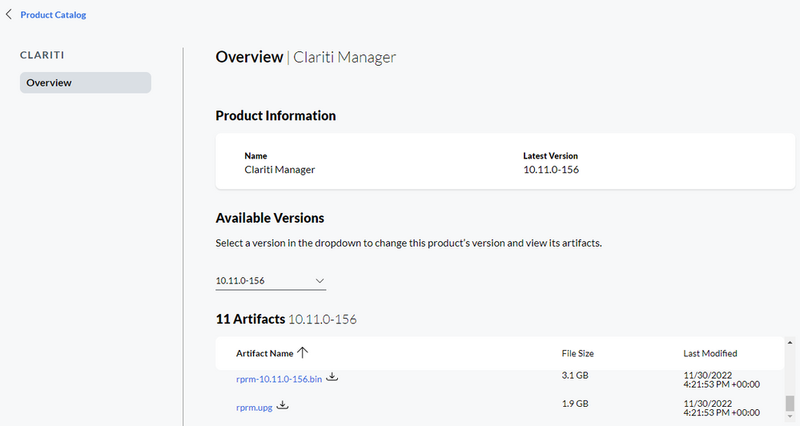

In Lens under Manage > Licensing > Clariti > Product Catalog > Clariti Manager virtual Machines files can be found

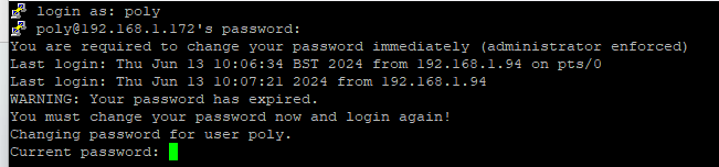

    Install the ISO or OVA on your virtual Environment. Once installed access the console to setup the Clariti Manager Network Credentials
    Username: poly
    Password: clariti
    Once the poly/clariti combination has been used to initially log on the password must be changed to a more secure password

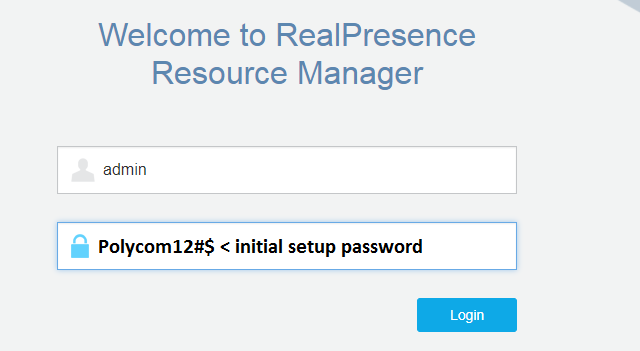

  4. Wait about 10 Minutes and then browse to the IP or FQDN of the RPRM
    The standard initial username is: admin
    The standard initial password is: Polycom12#$
    You will get prompted to change this to something more secure

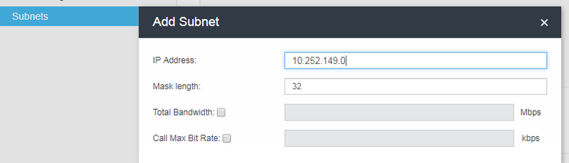

  7. The next step would be to assign a site(s) to create separate sites to match the environment.
    The above expects a Site Name, a Description, and a Location.
    In addition, define the Subnet
    If this is not defined the Clariti Manager / RPRM adds everything to the Internet / VPN

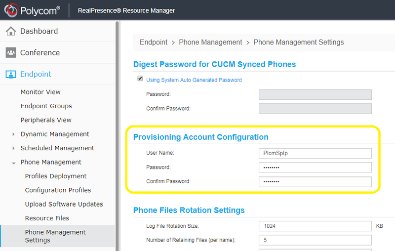

  8. The Clariti Manager / RPRM uses PlcmSpIp as the standard User Name and Password. This can be changed here:

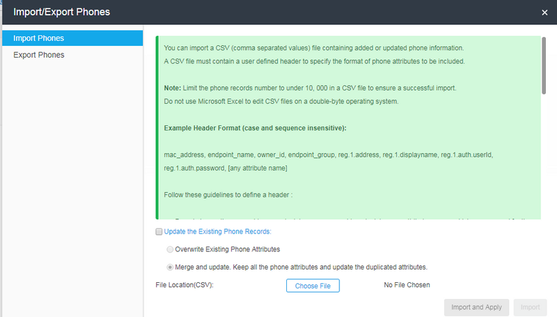

  • Importing all phones via a CSV File:
    The format of the CVS file is defined in the instructions which you can see above. You can in addition simply export a file and use this as a template.
    Devices can be imported and re-imported to change associated groups in bulk without changing other configurations.
    The advantage of this is all phones would already be setup with their registration details and utilize the DHCP Option.

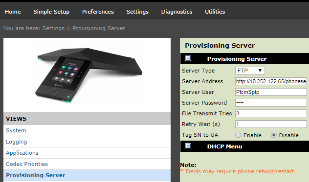

Option 2:
  • Manually providing the RPRM details via the Phones Web Interface
Once the phone is connected to the RPRM provisioning Server the Web Interface or Admin Password for the Phone changes to 789.
This can be changed by browsing to Endpoint > Phone Management > Configuration Profile and copying the AdminPassword-ProvisioningDefault.
This would then be required to be assigned to a Global Configuration within Endpoint > Phone Management > Profiles Deployment.

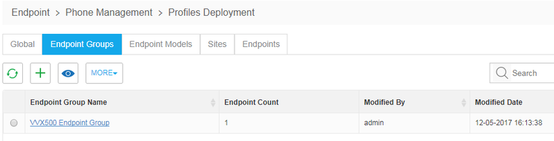

  • Using the Endpoint Groups as an example we can add and Group certain Endpoints together. In the below example we used a VVX500
    We call this new group VVX500 Endpoint Group
    And we associate this:
    This results in a new group

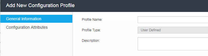

  • Browsing to Endpoint > Phone Management > Configuration Profiles you can either create a new profile/configuration (blue) or modify an existing one (red) once it is selected
    Either create and define what this profile does or change the name provided if cloned
    The options for editing or changing this vary
    You can simply start typing/searching for a parameter(s)
    or paste from a previous XML file

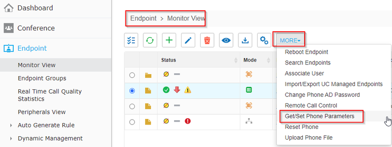

Get or Set Configuration Parameters
Via Endpoint > Monitor View > More > Get/Set Parameters a device can be checked to what value a parameter has been set:
Using the above will store the value within the phones <PHONE_LOCAL section. This will appear as made locally on the phone as explained => here <=

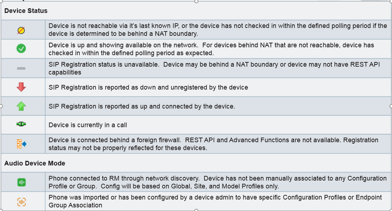

Endpoint Monitor – Device Status

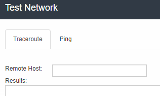

  • Test Network Connection > Troubleshoot network issues using the traceroute and ping programs. This includes a PING or Traceroute

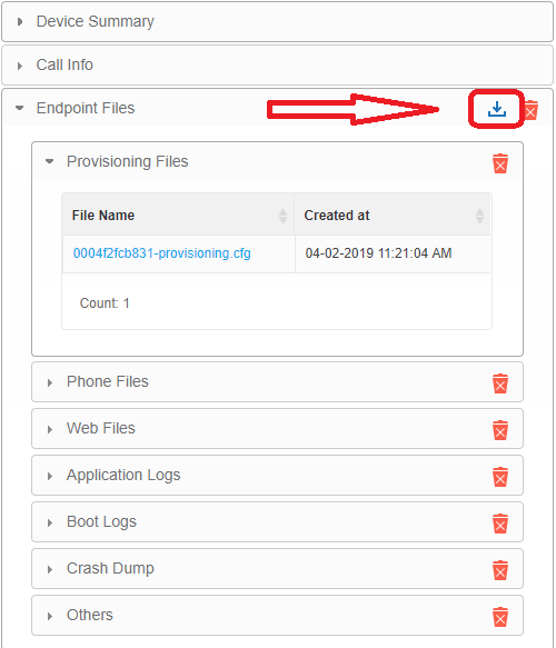

Gathering Logs in order to supply Poly Support:
Navigate to Endpoint > Monitor View and select an Endpoint and click on "View Details"
As a result on the left side an overview of all the Device Details are listed and all files can be downloaded:
Or simply individual Log Files:
In addition the amount of log files and the individual size can be modified to cover a longer time period.

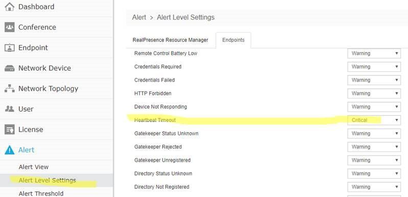

Start out with setting the Alert > Alert Level Settings
In the above example, we set the Heartbeat Timeout, to critical.

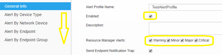

Set a new Remote Alert Profile
and either enabled in General Info and set all Resource Manager alerts and send the trap assigned
Or instead set this for VVX, SoundStation, SoundPoint and Trio again for Minor, Major and Critical in device type

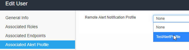

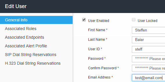

The next step is to assign this to a specific User > Users as an example:
Ensure the relevant User has a valid Email address within General Info.
and ensure to chose the Associated Alert Profile previously created
