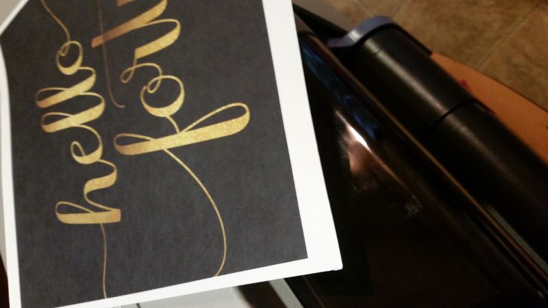

Update to say-- SHE WORKS MARVELOUSLY! Huge thanks to this forum and especially the many posts on this model from davidzutz! I now have a working machine for less than $120 total investment 🙂
Cyan arrived in two days, seller was fantastic about replacing the missing head (discountinkllc) but I got sick and put it all off for a few days. Purged tubes with syringe before install. I almost messed up bigly though when installing the new printheads-- I had no idea that there was a 'cap' that goes over the metal needle inside the circular piece at the bottom of them when they are new, almost just jammed them in there and was confused for a minute!
The alignment and first few test prints had a bit of a black pooling/smudging issue but that could have been due to the paper I was using at the time (cardstock) as regular printing papers looked fine-- I did eventually get another brand of cardstock to work, below is a 11x14" test on normal resolution.
