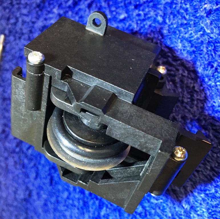

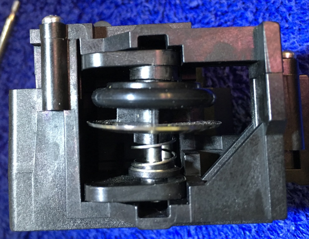

Thanks Mike I checked, cleaned and lubricated things.
The "tire" O-ring was completely missing!  Before I bought this printer, I had never seen a 5500 before and I didn't know that the cutter was not supposed to make an odd noise.
I got a new O-ring from the hardward store, I forgot what the inner and outer dimensions are for the tire, but, it's fat.  The pics below give an idea of the size, I don't know if that is the correct size, but it works great.  Thanks for the advice to take pictures, I took a few but I highly recomend taking lots of pics.  After you take the screws out which hold the two halves of the cutter assembly together, hold it together because the strong spring will cause the halves to fly apart.  Try to get a picture on the main piece after the screws are out and before the spring flies  so you can see how to replace the main spring.
After installing the new tire/O-ring, the cutter works perfect. It's quiet and the cut is perfect compared to the cut I was getting before.
