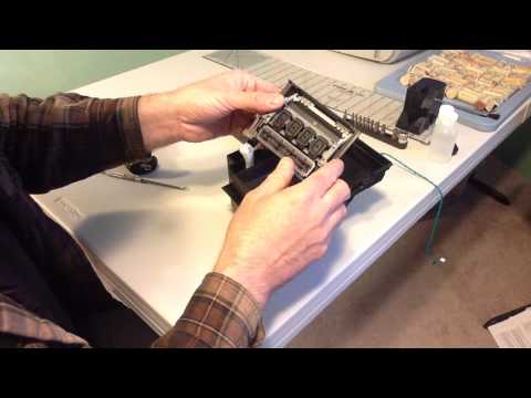

Service station working principle:
When printer is in swiched off mode, carriage assy parked in service station, during this condition service station protects print head nozzle to avoid open atmosphere with the specially designed caps... These caps locked the print head as well as locked the service station. During this condition carriage cannot move from the parked pace.  Once printer switched on service station releases the caping and moves little bit backward to allow varrage to moce from parked place. Once carraige intialize to left side and comes to service station area to clean print head nozzles with the help of wipers located in service station. Once nozzle clean completes again carraige parked in service station for the ready state.
What you are facing that service station not relising the serice station beacause of its not at all caping due to serice station bacame handicapped, video also showing the same avidance.
Try it.
Take out service station, remove station motor, manually rotate main drive gear(shown in fig) & observe wether wiper is moving freely or not, if not open the service station & check where is the obstaction. If found damage try to repair it or replace it.
Below youtube link willhelp you to how to open service station..
Note: While refixing the serice station remove washers fix the screws( in video I obersved it)
https://www.youtube.com/watch?v=97IXfoBefDY#action=share
Cleaning and re-assembling the HP Design Jet 500 printer service station part 1
