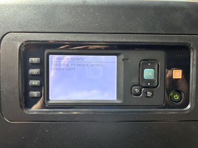

I just repaired my DesignJet Z6200 after the 24:10 Broken Bag but I cannot get out of the error screen. I tried the restart, holding down cancel+power+down arrow many times. I’ve unplugged it from the wall. I also tried to reinstall the Firmware by putting in the USB and the printer fails out after trying “USB drive does not contain valid firmware file” which I actually think is false because it came with the printer. Can anyone give me idea of what might be going on or give me another way to clear this error? (See photos). Incidentally, when I restart the machine, the initialization goes up to 33% and then goes to that error screen. Not sure if this helps. Thanks!

Thanks so much for your suggestions. I tried that a few times and it doesn't seem to be working. First, the beep never happens. Second, the printer either shuts off, because I have the power key pressed too long or if I let go earlier @ a pretty quick 5 second count it does what it always does and continues initialization and rests within the same error screen it always ends on (24:10 Broken Bag). I have added a YouTube  link to the a video I shot of the sequence here:
Incidentally, you'll notice that the initialization only runs to 33% and then straight to the 24:10 error screen. I am starting to wonder if there's something going on with the hard drive because as per pg. 16 in the service manual saying: If the printer continues to stop during the power-up process, replace the Hard Disk Drive  - See Hard Disk Drive (HDD) on page 340. Does this sound like a possible diagnosis?  I have ordered a drive from Amazon ($36). I will let you know
