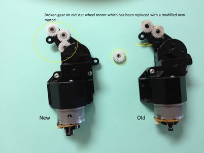

That is a broken starwheel motor, a known issue on that printer model, which needs to be replaced, and firmware upgraded to prevent it from happening again.
My profile on LinkedIn
There is a service bulletin on this product that shows that one of the brackets break. A new upgraded part is now supplied part number Q6718-67017. As I posted on Spiceworks,  you need to take this apart before ordering any parts to determine exactly which part has broken. Depending on the HP documentation I look at, there are different causes and fixes listed.
