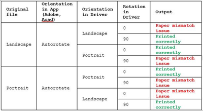

Usually by following this table will fix that issue, check what option applies for you, and let me know if any works for you.

Holy.... this does not make any sense, but it is printing correctly now as of 2/3/2021.
I have tried all the combination on the chart you provided in December, and in January, wasted whole bunch of paper and had mismatch issues.
I updated my drivers (removed all old ones v3, v4, pcl, etc... from system, even went into the registry) to 3.3.6.1545 released on 1/29/2021- and tried again with your table today and it is printing correctly with AutoCAD.
These are my settings: in AutoCAD, Landscape. In Printing Preference- 24" Roll, Arch D, Portrait Orientation, Auto Rotate.
I am guessing the latest driver fixed the auto-rotate issue because it would not auto-rotate with any kind of paper orientation in the previous driver version released in December. My plotter is showing I am using 24" roll on the display, but when the job gets to the printer, the printer is asking me for 36" roll and showing mismatch warning.
