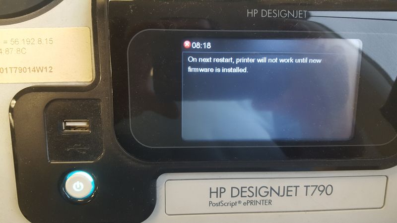

Hello! I'm an agent of the US Postal Service, and I've been tasked with repairing an HP Designjet T790 Plotter Printer we have at site.
Originally, this device was showing an "error 08:18 When printer is restarted, it will not work until firmware is updated", and was not responding to any input, as you can see below: Designjet T790.jpgInitial errorI fixed this by going to HP's website and downloading new firmware (Reference: Support.HP.com was the website I got the firmware from) and moving Firmware 6.0.0.2 onto a USB drive, then migrating it to the plotter using the USB port you can see in the image above.
And it worked. Pretty perfectly. It recognized the firmware, installed it, rebooted it, and everything looked like it would work.
