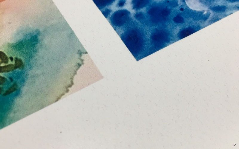

My printer(Latex360) has some noise
Image quality printing and printing work have noise
First of all, I think it is caused by RIP, but the image quality prints the same problem.
Not paper pollution ,  it is a regular ink drop
some one can help me ?
printing workprinting workImage quality printingImage quality printing
This happens when you have faulty printhead (PH)  with many missing nozzles or spaying all over but not in straight direction, check LM/LC and optimizer's PH. If all is good - clean the printheads and  make an alignment.
Also happens when humidity is high (when raining) and substrate surface becomes moistened...use another substrate and check results...
And some other thing - when printing - use color bars (make them about 1cm wide) on both sides of the printed image and push the lights. When printing take a look which printhead is spraying not printing straight line....
Could you take pictures of Printed test plot of all PH's (separately for each Printhead) and post it here?
An hour ago, i update firmware NEXUS_01_16_00.8
Reset the machine, and clean the printheads and  make an alignment.
it looks good now, I will observe again,
thank you Skuks 🙂
An hour ago, i update firmware NEXUS_01_16_00.8,
reset the machine,  clean the printheads and  make an alignment
It looks good right now, I will pay attention to it again.
thank you Skuks
I'm glad I could help at this one 🙂
