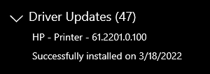

From reading another thread i think i see the cause but don't know how to resolve it. other thread mentioned that driver numbers need to match(see image). i just notice that windows installed an hp driver on the march 18th. i had no issues before the March 18th, so this leads me to believe this may have something to do with it. doing an uninstall didn't work. and i don't see where this driver is located so i can attempt to roll it back. any ideas.

Hey, could you go to your windows update section in settings and goto view update history. and under driver updates do you see HP - Printer - 61.2201.0.100. i think this is causing the issue. but i don't see where to revert or remove this update.

yea mine installed on the 18th. and my 1st print afterwards prompted the out of date message

Yeah i think this is the cause. HP needs to update print preview drivers so they are on par with the HP - Printer - 61.2201.0.100. Because currently print preview version is 2.2108.1.142. Read in another post that the 2nd numbers have to match. Screenshot 2022-03-24 110005.pngScreenshot 2022-03-24 110005.png
1) You can try to uninstall all.
2) To stop automatic update:
Run command sysdm.cpl and go to the hardware tab. Click device installation settings and check no.
3) Install 61.2108.1.100 drivers from HP
Hope this works until HP update to 61.2201.0.100 drivers for HP Print Preview
