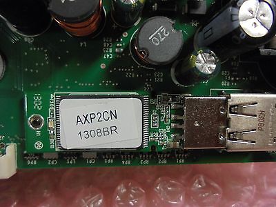

Main reason for the Encrypted Chip, which is not orderable to HP. That's why need order whole main board.
If still problem persist, please replace the Main PCA and Encrypted Kit. That is the proper channel.

If not covered under warranty you may replace Encrypted chip which is failed on the mainboard inside the printer you can buy it on ebay:
HP DJ T520: http://www.ebay.co.uk/itm/HP-Designjet-T520-Blue-Screen-Error-Solution-Encrypted-chip/282230954091
HP DJ T120: http://www.ebay.co.uk/itm/HP-Designjet-T120-Blue-Screen-Error-Solution-Encrypted-chip/282211348454?_...
