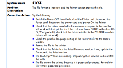

Hi again. I tried that several times. It made a very short lived, minimal impact. I got some color printed and then it all just stopped again. The print heads look ok visually. I think because this sat for so long - there may be air in the system. I have tried to do the purge ink function from the front panel - but I get ab error 61:01 format error and I cant purge the ink system. Any thoughts? On-line it talks about drivers - but this is from the front panel that I am trying to do the purge.
Thanks again!
61 error is a file format error
